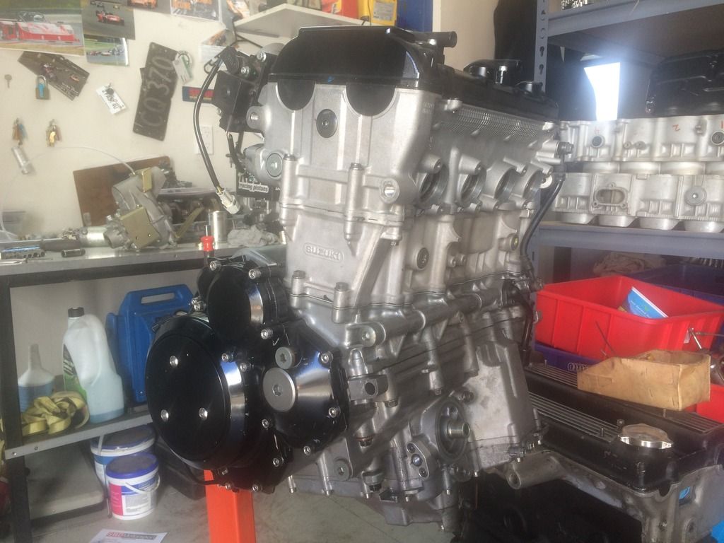

The engine thats going in

Just about to start building up the engine. This engine has lower compression pistons than my race engine as this will spend most of its time on 98 octane, while the race car is on e85

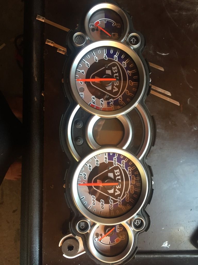

Gauges are modified and the new lamada, oil pressure, oil temp gauges that will be installed into the carbon dash
