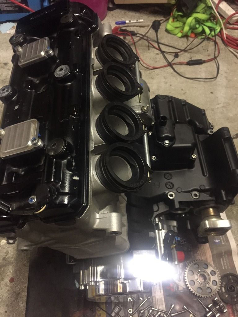

Have stripped the engine down as looking to make it more stealth.
While we're in there we've posted more galleries to help with oil pressure. Plan is to have 275hp

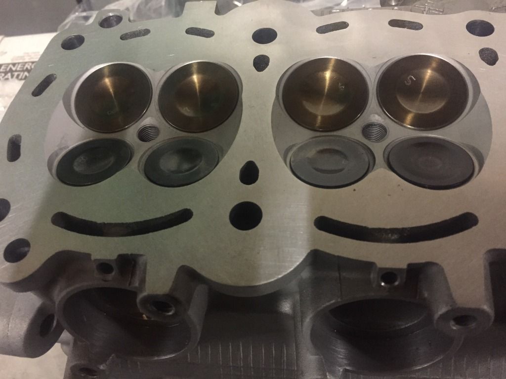

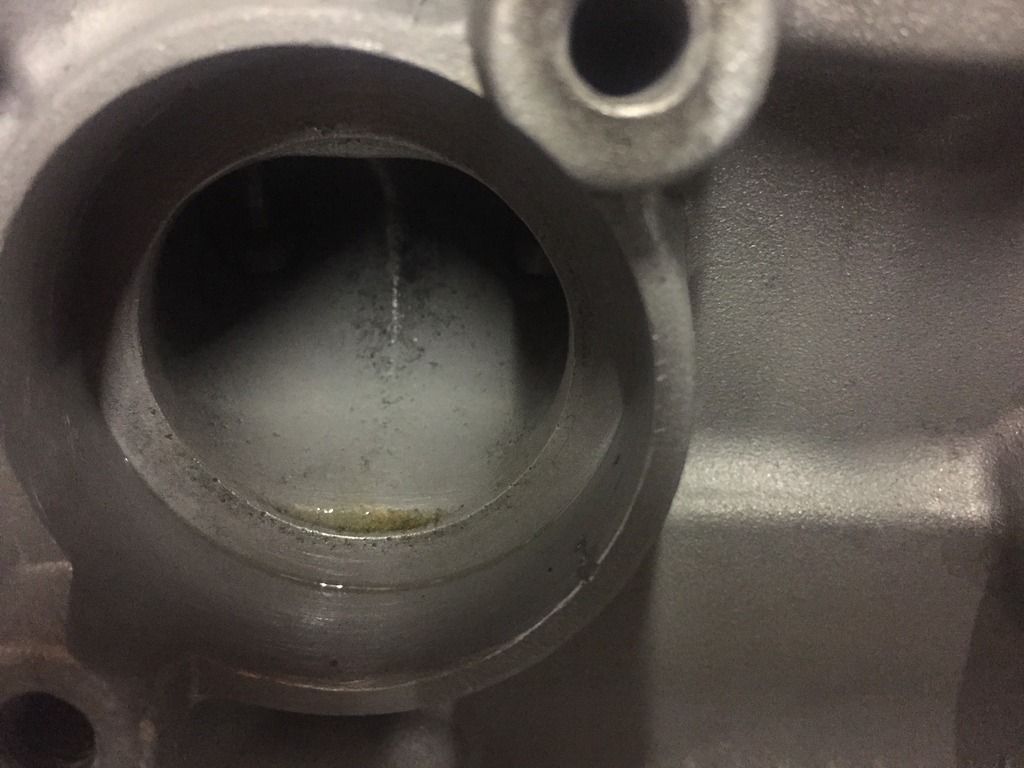

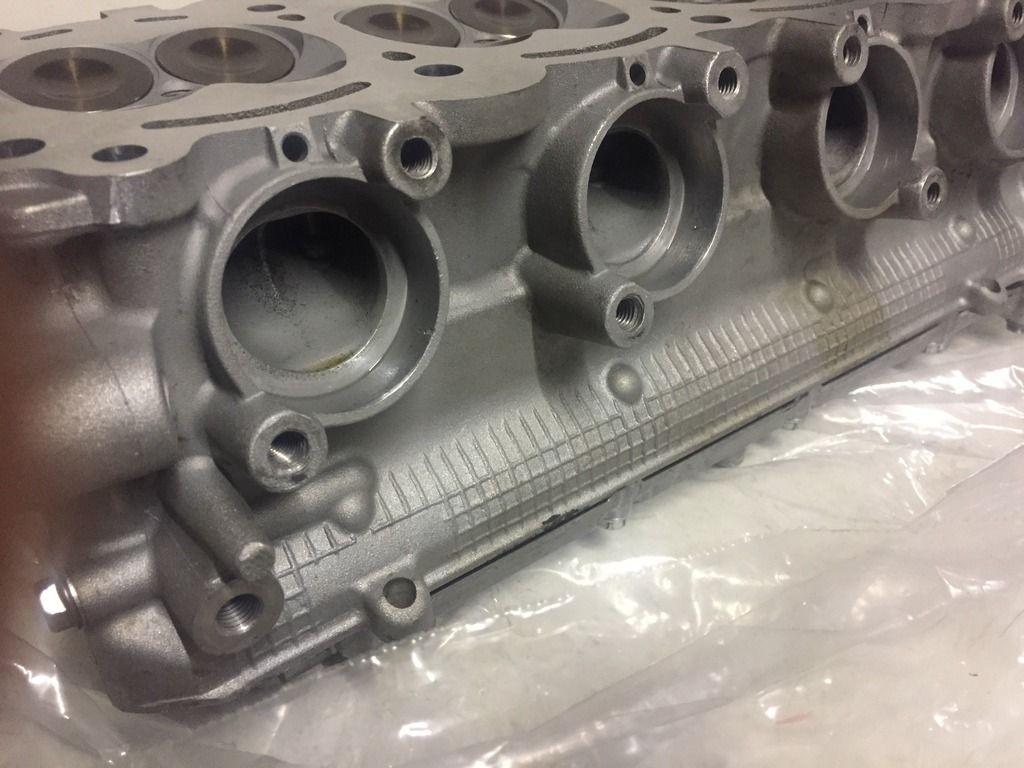

I'm liking the look of the engine with the satin black case and then alloy barrel and head. Here where I'm at tonight
Carrillo rods fitted
Crank polished and measured
Forged Turbo pistons fitted.
Head back from a service and a little porting. Full stainless valves and degreed cams
