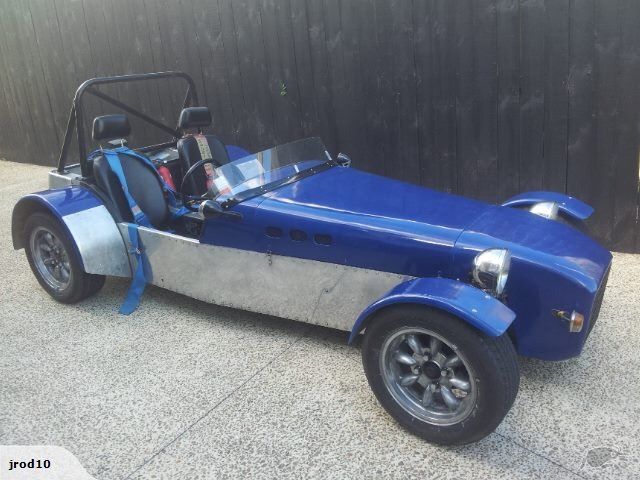

Finally found something as a base for my winter project.
The plan is to convert this into a fun weekend car that can hillclimb. The car already has a Motorsport nz certified cage, car is also road legal and fully certified
the engine will be upgraded from a 4age and t50 to a gen2 hayabusa turbo. Engine is already under construction and will include Carrillo rods, turbo pistons, adjustable after market cams, stainless valves and ported head
The car will have race spec Penske adjustable shocks and already has push rod suspension
