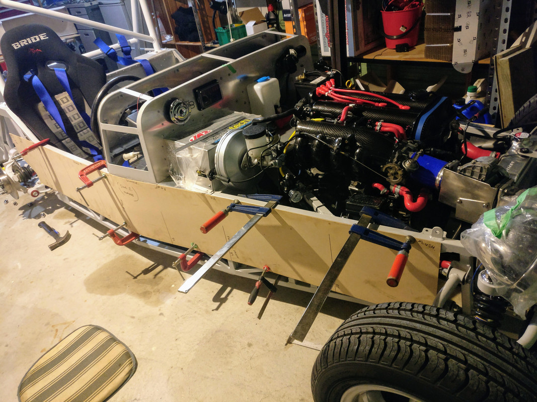

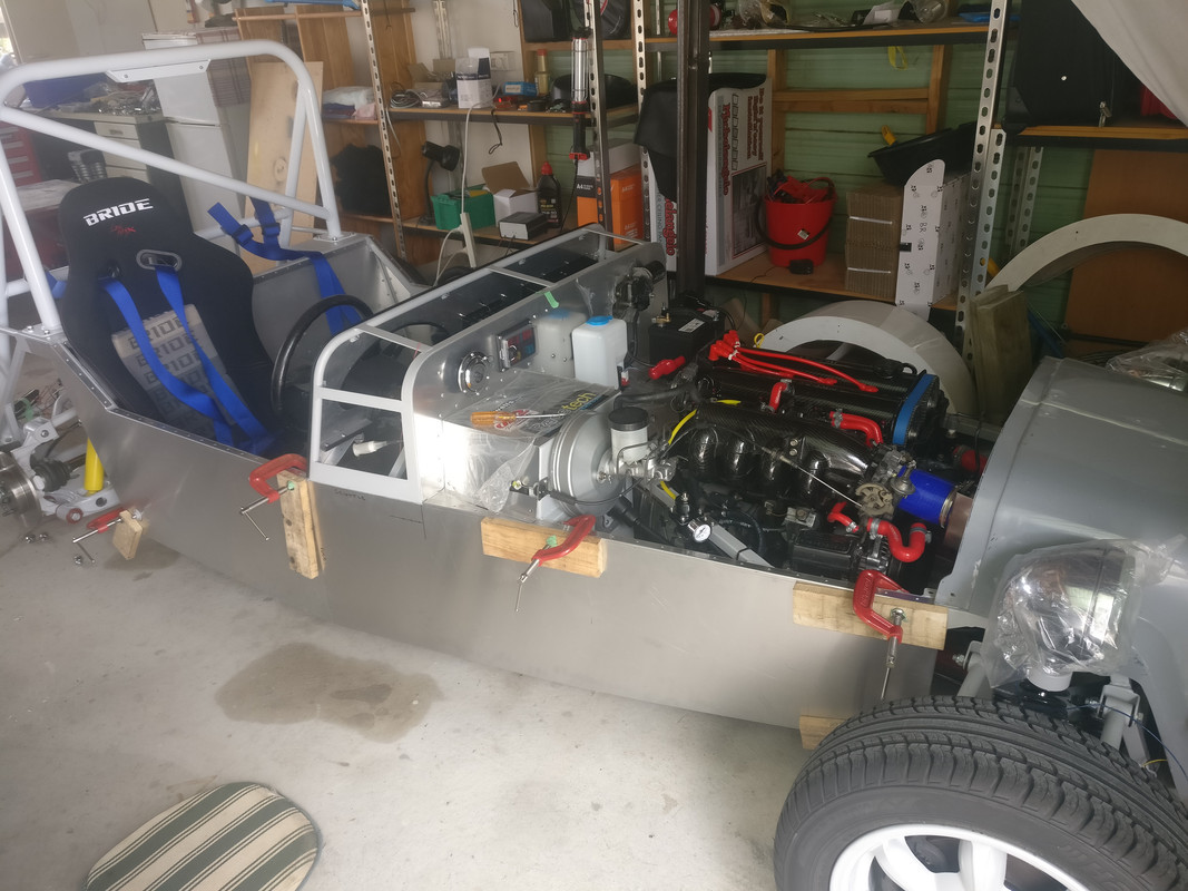

Post by Wanganui7 » Tue Nov 27, 2018 7:13 pm
Yesterday wrapped a board around the right side of the chassis and marked the dimensions for the outer panel. Hope to fold it this weekend. Also changed my mind about the vinyl I had covered the consol with. Removed it and recovered with the carbon fiber vinyl many use. A big improvement. Picked up some carbon looking mirrors from Trade-me to be mounted later. Needed to turn the car around in the garage to get more room and with the engine now running drove out, backed up and back in again. Careful that I only had a handbrake as the front brakes arnt hooked up yet.

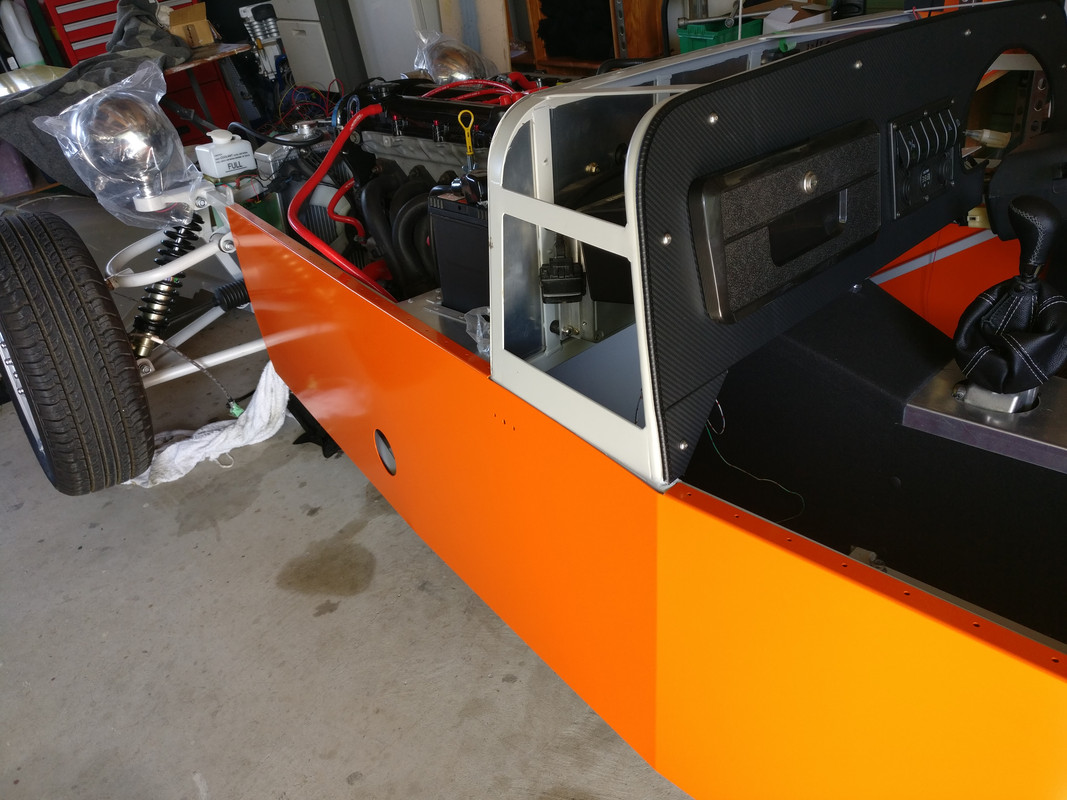

Post by Wanganui7 » Sat Dec 01, 2018 8:51 pm
Went into work this morning, cut, drilled and folded the second side., Took it home and tried on the chassis. Fits well so im pre drilling all the rivit holes in the chassis for both sides and will get them powder coated next week.

Post by Wanganui7 » Mon Dec 10, 2018 3:49 pm
Picked up my side panels today from the powder coaters. Almost a dayglow orange. Guards and scuttle will be white, which I'll probally spray myself , to break up the shockingly bright color.

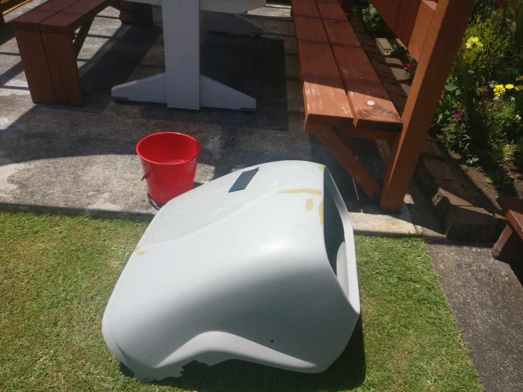

Post by Wanganui7 » Sun Dec 30, 2018 7:14 pm
Having two weeks break over the Xmas holidays and the wife overseas, has given me lot's of spare time to work on the car. So far I've finished fitting the interior panels and carpeted them. Today have cleaned up the nose cone. A second hand Almac one cut down the centre and 60mm removed to fit my chassis. Fibreglassed and bogged up . Two coats of 2D primer sprayed on today. Rubbing down between coats while sitting under my pagola in the sun. Tomorrow I'll apply a couple of coats of bright orange, matched to the powder coated sides .

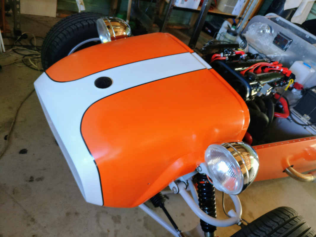

Post by Wanganui7 » Mon Dec 31, 2018 9:57 am
Gave the nose it's first coat of orange. Will rub down with 240 grit paper and respray in the afternoon. Later to be followed by a white stripe down the middle and around the mouth. Very pleased with the colour match to the sides.

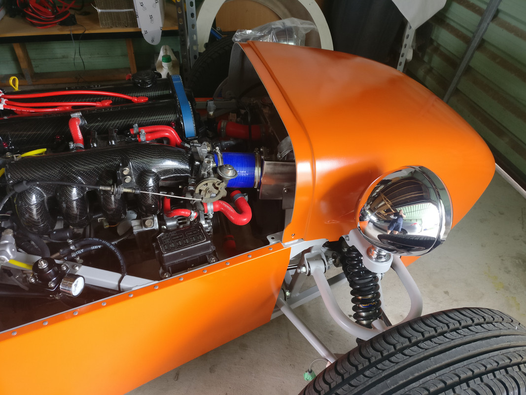

Post by Wanganui7 » Sat Jan 12, 2019 6:32 pm
This week have been fitting the front hard brake lines. Today bled them and all working well with no leaks. Couldn't resist a little squirt down the road to try them out. Nice smooth effortless braking as have kept the booster so many don't use. Also pinstripped the nose cone. Just needing a coat of clear and a polish. I got a Caterham super 7 badge for top of nose and a stainless steel 7 grill badge from the UK . Will make a wire S/S grill to mount it. Working for a shelving company gives me access to a wire spotwelding machine, so will be easy to make.
