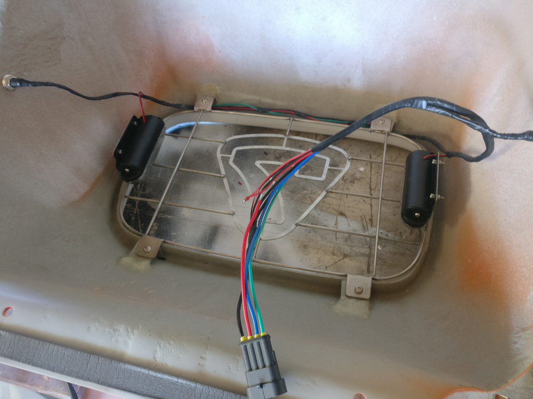

This morning worked on the stainless grill . Started off trying to use 5 mm wire but found it very hard to bend. Seamed to work harden. Changed to 4 mm which I bent around a dollie welded to the bench. Tig welded with the 7shield brought earlier off ebay . About two hours work to do. Still to do mounting brackets also fit the led daytime lights in behind. Am thinking about fitting some woven stainless steel mesh in behind to. Had previously brought a silver and black enamelled super 7 badge from UK but it didn't stand out very well so ordered two black and yellow ones instead. A big improvement and they just happened to be on half price special.

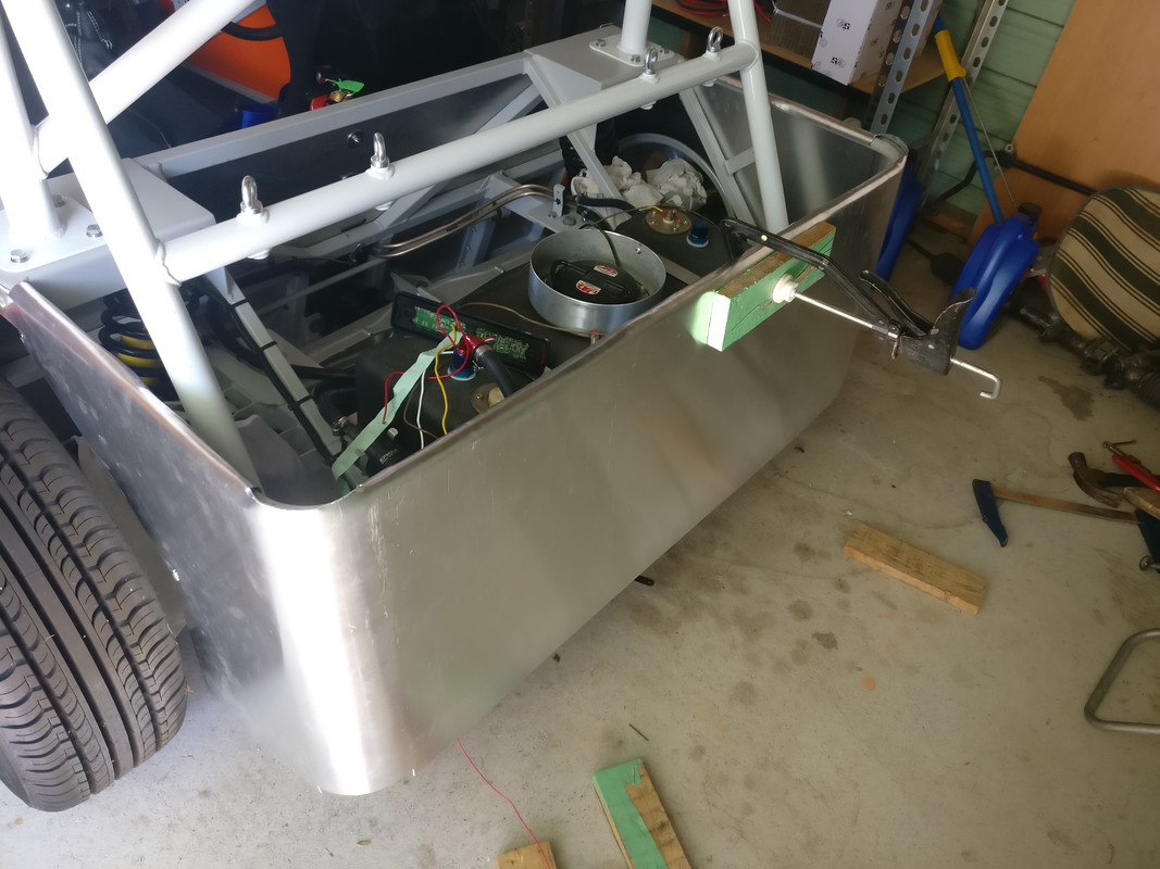

Today started working on the rear panel. Cut some alloy oversize and had a friendly local panel beater roll the corners for free. Always find car guys a friendly bunch , down to earth and willing to help. Clamped to the car , marked and recut closer to the finished size. Fitted to car again and started to roll the top edge over using piece of wood as a dollie and hammer. The tube your rolling over is only 19mm and bounces a bit while hammering so I will take off car , fit a solid 19 mm sold rod inside rolls for final hammering and finishing. With this done just needs some right angle bends on the press brake.
