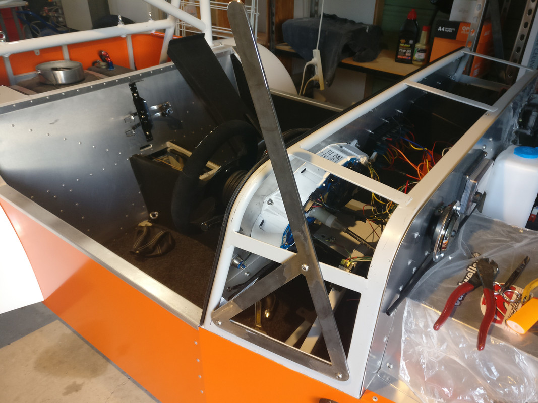

Post by Wanganui7 » Sat Apr 27, 2019 8:49 pm
Been slow progress over the past two weeks having to spend time fixing another car. Just finishing smaller jobs, a bit of painting and tidying wiring. Today made a start on the windscreen making the side stays and next will decide on the height of the screen and make the alloy channel frame.

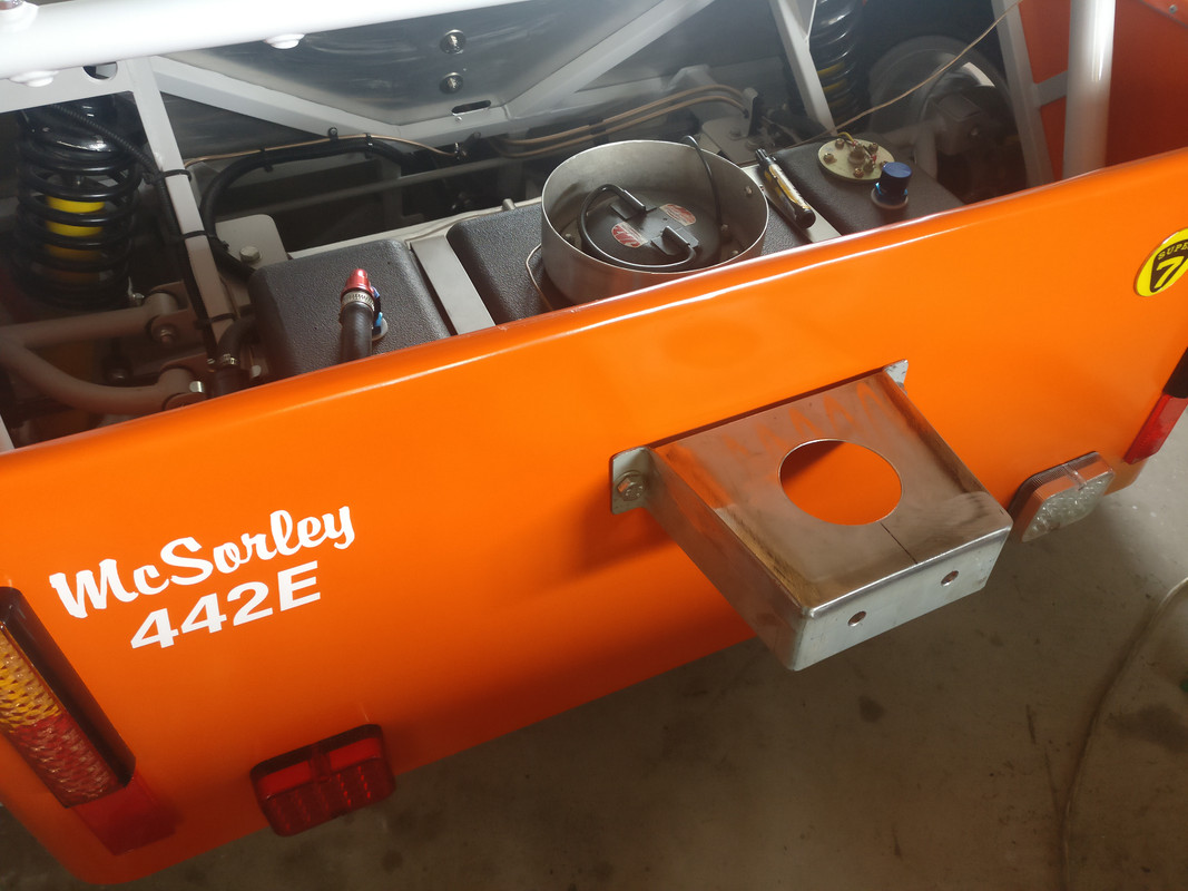

Post by Wanganui7 » Sat May 04, 2019 11:23 am
Knocked up a bracket to mount the spare wheel in my lunch hours at work. Bit ugly but after powder coating orange and the wheel on, won't notice it. My old old car never had a spare and not a flat tyre over 11 years, but I'm mostly using this one for touring so thought I'd better have a spare.
