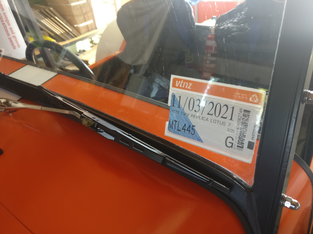

Post by Wanganui7 » Thu Mar 12, 2020 4:52 pm
Having finished the LVVTA cert process it was off to the testing station for WOF and registration. The night before went for a little squirt around the neighborhood to make sure everything was ok only to notice a leak of coolent when I got back. Came from the thermostat. I'd put in a new gasket but it had turned to mush. Replaced it with silicon and next morning was set enough to drive the car. So by lunchtime car is now warranted and registered. Nice evening tonight so it's off for a cruise in the countryside. Looked up my first picture off my build to see I started February 2016. So only 4 years to get on the road. Wife always said I took a long time to do things :)
