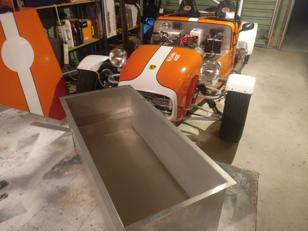

Replaced the clutch master and slave cylinders and have cured the problem. Although the car is now on the road, the build goes on. I have folded up a tool box to fit over the diff. Large enough to store the jack, handle, pump and a few tools. Also have purchased a few chrome fittings for the roof frame.

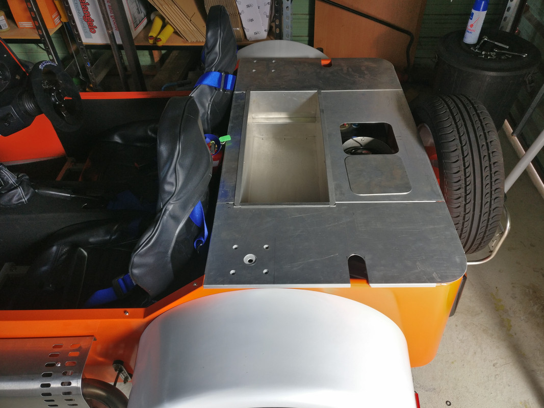

The four week lockdown has given me time to work on the rear cover. Just need the corners welding, when I can get back to work, and powder coating. Dog didn't approve of the boot space ,but it's all I could manage. Matbe I could get him a pair of goggles. Am also moving the inside rear view mirror down nearer the dash and might reposition the outside mirrors a bit higher.
