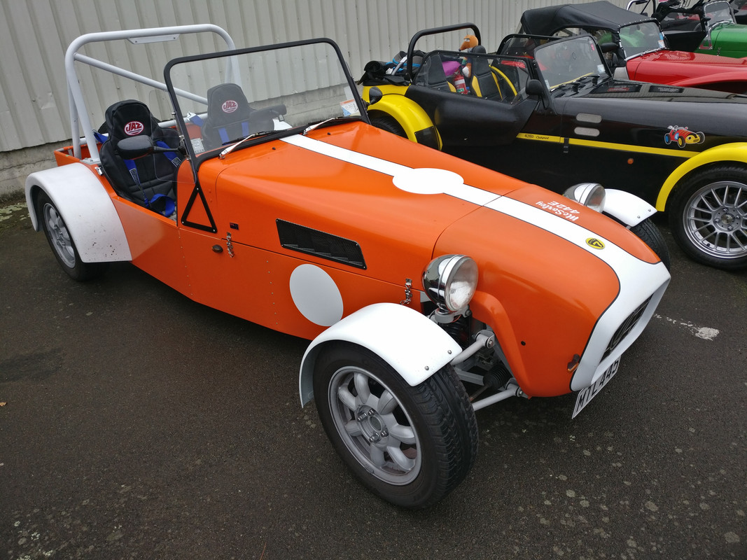

Post by Wanganui7 » Thu Mar 12, 2020 8:47 pm
In the evening after work packed the wife into the passenger seat and we set out for a first run. Headed north out of Wanganui for about 20 km, not going to far incase we suffered some problems. But car ran faultlessly. Great around corners but with a soft ride. Incredible braking. I had set the engine timing advance to 10 degrees as recommended on the mx5 race forums. The power is very docile up to 4000 revs then comes on strong. Am thrilled with the overall car, better than my old Striker in every respect. Still lots to add to it in the coming months , but so happy to finally have it road legal.

Post by Wanganui7 » Sat Mar 14, 2020 3:31 pm
After first run the leaking thermostat gasket came back to haunt me. Fitted a new one for the second drive and this time no problems. Had no co-pilot this time so was able to push it a lot harder . I'm going to get my wife to film it when I can get to Manfield. Have a look how it sits through the corners and if it would benefit from a front anti roll bar, as I've already fitted the mounting points for one.

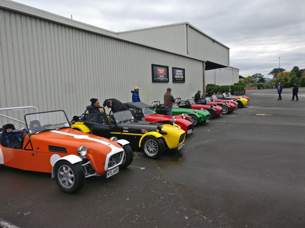

Posts: 95
Post by Wanganui7 » Sun May 31, 2020 2:50 pm
