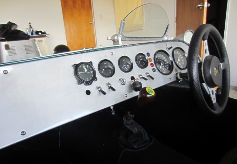

My dads a watchmaker so to fill the hole in my dash where the volt gauge use to be I now have a clock. Its got the markings for military and is dated for WW2. Wonder which warbird its out of?

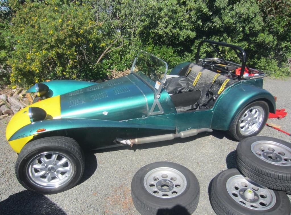

Did a 900k round trip to Napier and back to pick up my new wheels.
They look really good. Problem was my nuts for my old wheels were too short and the long nuts that came with the wheels were the wrong thread. So I had to carry 4 wheels back with me
So now I need to find some long 7/16 lug nuts. Repcos and supercheaps only have standard short ones.
