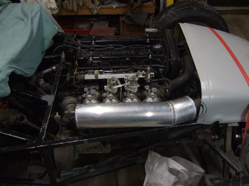

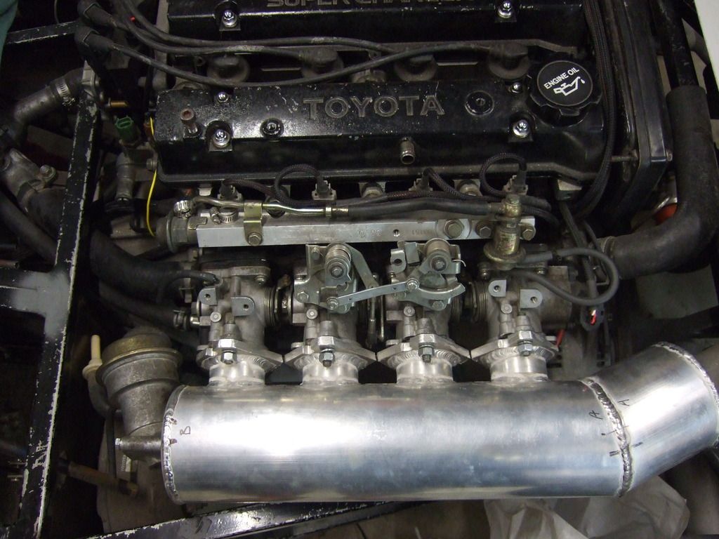

Dave, engine is 4agze+turbo. a wider chassis in general, front track to match wide rear diff set up, wider cockpit to suit wide driver. i struggled to find seats to fit standard locost chassis. i just fitted without a seat, i looked at my go kart seat #36 and that is even too wide. intake plenum hangs out drivers side etc, i did manage to get it all inside the nose cone i have, just...

The lower BJ, is a Previa lwr joint made from 1991-96, 2WD Moog P/N K9825. For the upper BJ I used a Ford F-250 tie rod P/N ES-150R which has 3/4-16 NF threads. I cut down the stock Toyota seats to fit, and then recovered them. If you can find older Porche 914 seats they are only about 16mm to wide and will compress that much. If you can find a newer Volov XC90 at a pick & pull, the 3rd row seats will fit in the space. If interested in modifying the Toyota seats, I could send some notes on the disassembly and mod process.
I also had to put a bubble in my hood for the throttle body linkage, plus cut down the oil filler neck on the cam cover for clearance, and that is with the oil pan seating 35mm below the frame rail. Dave
