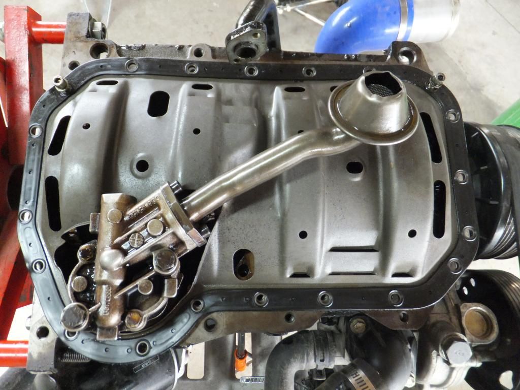

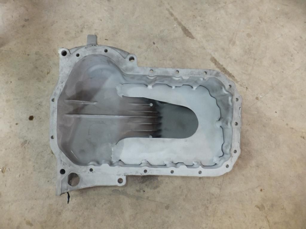

Post by bzrse7en » Sat Nov 26, 2016 9:04 pm
Well, checked just about everything on the outside of the engine, no smoking gun.
PCV system is now as clean as a whistle. Pressure Gauge is not faulty. The head return galleries are clear - there are 5, so unlikely to be blocked anyway.
This morning cold oil pressure wasn't as high as normal and it was moving up and down 10 psi, like the pressure relief valve is floating. I took off the oil filter housing, blew compressed air into the galleries and back thru the pump. Re started it and pressure went up to 80 psi, normally it has been about 70. I figured I had fixed it. However once warm and with some spirited driving (not aggressive) the pressure dropped off. You can see it drop slowly straight after giving it the boot when hot. Pressure dropped to 10 at idle and 25psi at 3000rpm. Letting it stop and cool for 5 mins and the pressure comes up another 5 psi, but drops back soon after. on hot start up, the gauge overshoots, then drops back.
A mate kept saying it could be the pressure relief valve and I dismissed this (only because it is hard to get to), seems he might be right.
Here are the photos of the windage tray and baffle, I cannot see any issues with them... maybe I'll open up the holes below the big ends.
