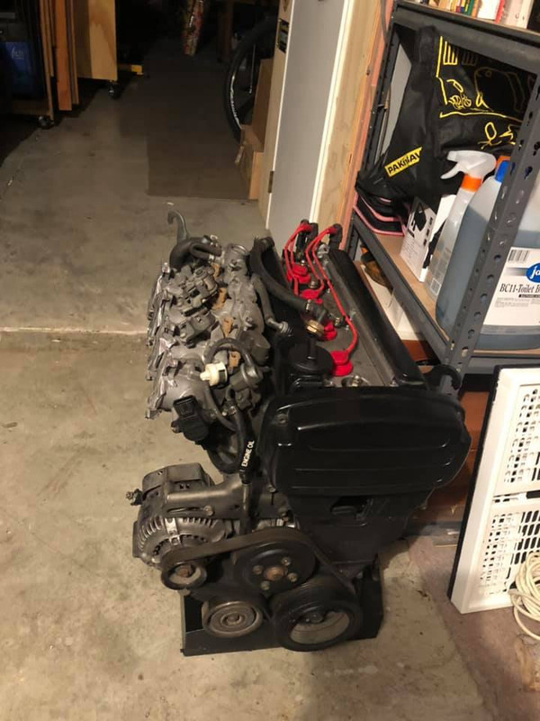

Car has been going well, but we are having to put more and more oil into our 4AGE Blacktop motor on every run we do. When we brought that engine for the Fraser, it had done 130000kms, and now it will be touching on 200000kms, so it is time to do something about that.
We have since brought another Engine of Trademe for $700, and intend to strip this one down and replace parts as we go. This way we can keep enjoying the car with teh current motor, and take our time with teh rebuild.

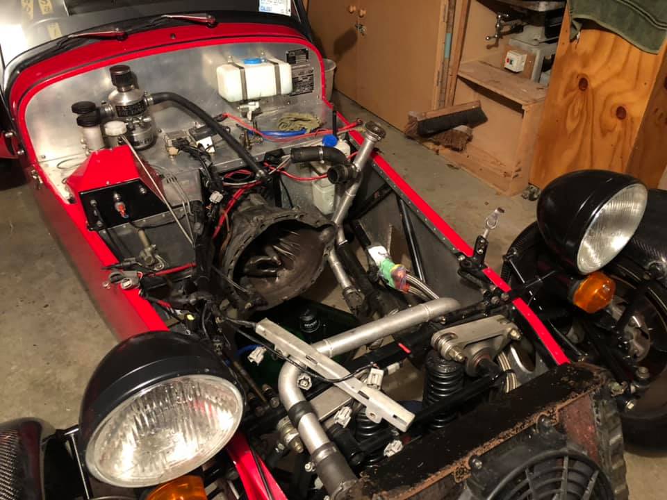

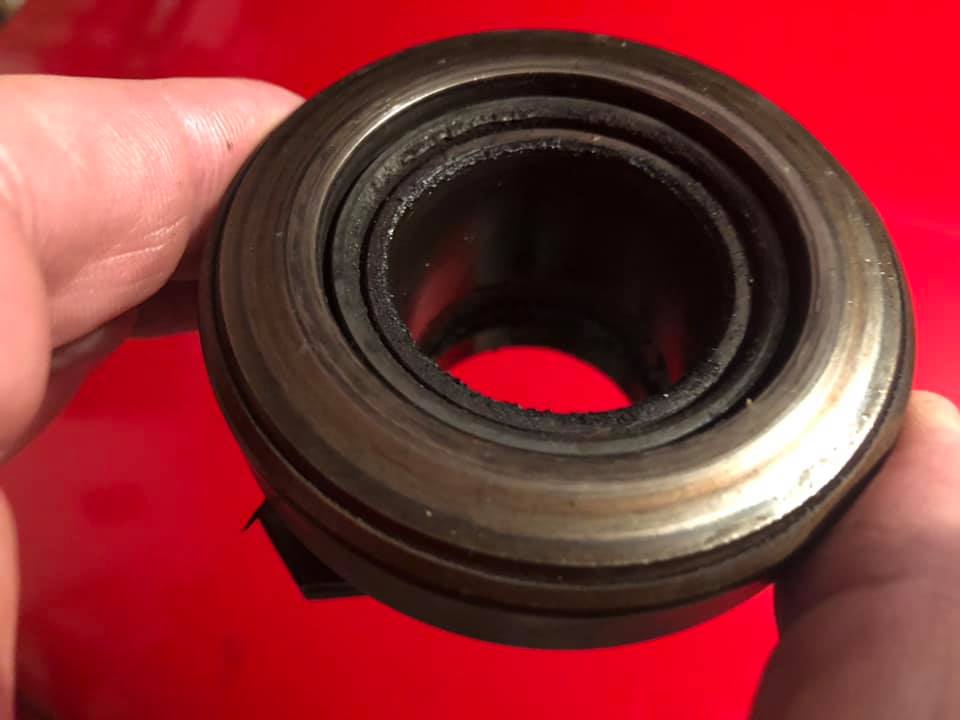

Just thought I'd post a few things on here. I recently attended the constructors car club driver training at Manfield, it was a great day out with plenty of track time. Near the end of the second session the car just didnt feel right so I went back to the pits, where a very strange rattling noise was coming from the clutch area. I worked out that it must be the release bearing, and decided it would be right to nurse home, trying not to change gear too often.
Anyways, engine came out to find the Release Bearing had completely siezed, which had worn out the "fingers" on the pressure plate, so new clutch ordered with release bearing and installed.

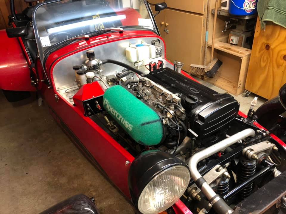

Post by flewy » Mon Nov 18, 2019 7:34 pm
Some blingy bits for the upcoming engine rebuild
