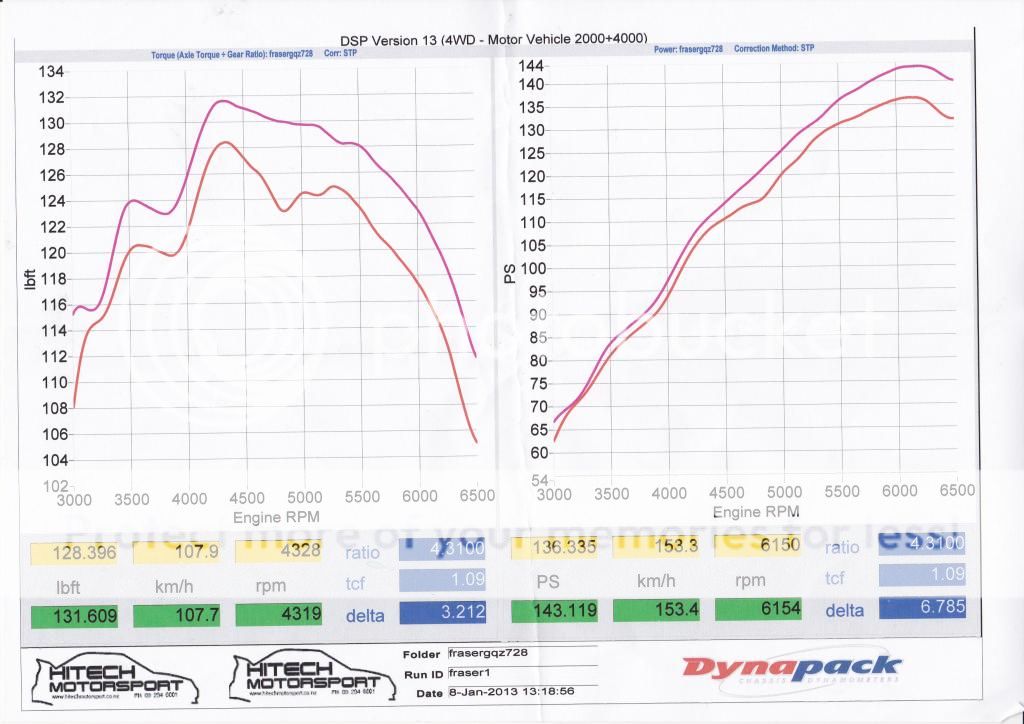

Results of yesterdays dyno and setup...
Still slightly over rich at idle but in order to fix this means work on progression holes so it'll be a carbs off..
much more responsive on acceleration now though so can't be bad :D

I need to do a dyno run and tune up my carbs. Do you recommend these guys? Do they know much about webers and old engines? What did it cost you to get it tuned? (pm me if you dont want to post here)

I'd recommend them. Bob's been in the business for about forty years so hes worked on a lot of engines. Really knowledgeable guy. I ended up being there for a few hours so may be worth dropping the car off to them rather than hanging around.
They prefer taking the mixture reading off a lambda sensor rather than shoving a probe up the end of the exhaust, so i now have a blanking screw on the exhaust for future tune ups.
