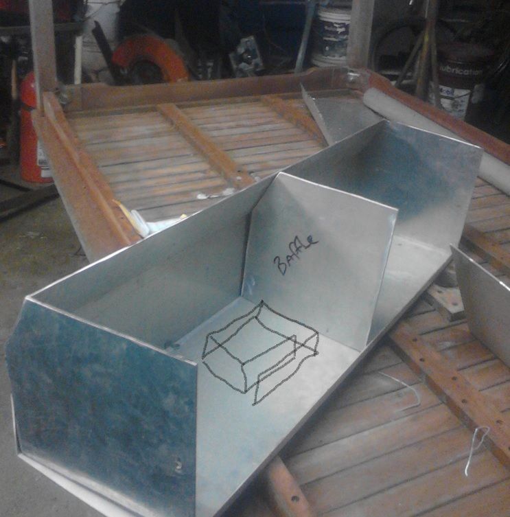

so I found an aluminum cover just doing nothing and thought it looked a lot like a fuel tank. Measure it and the car space up and I can make a 30l tank out of this that will sit behind the MX5 subframe and give me a boot. It will have one baffle and an internal swirl pot. just have to find a piece of 3mm Al for the top and back.

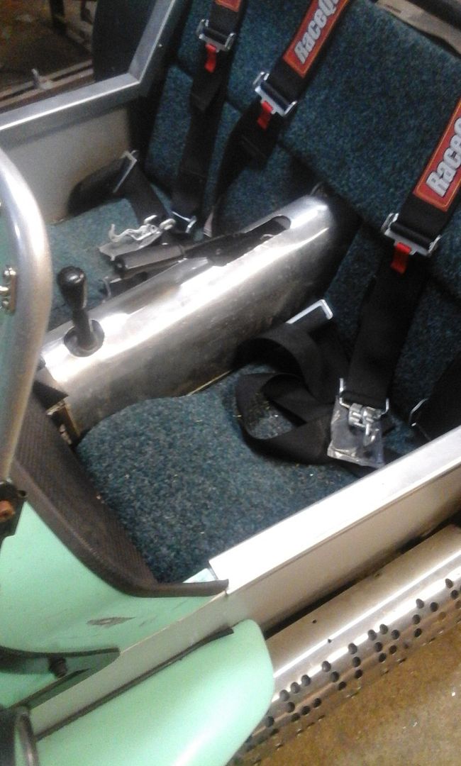

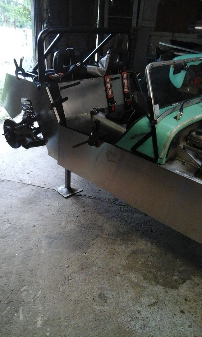

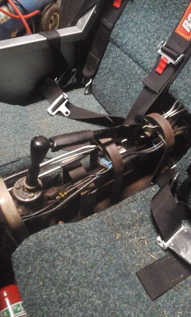

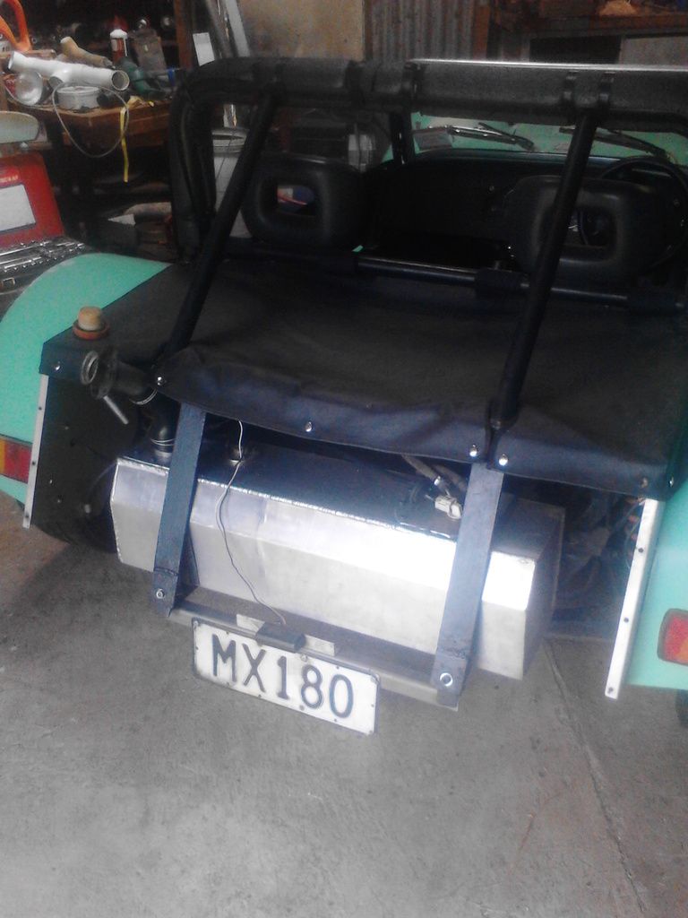

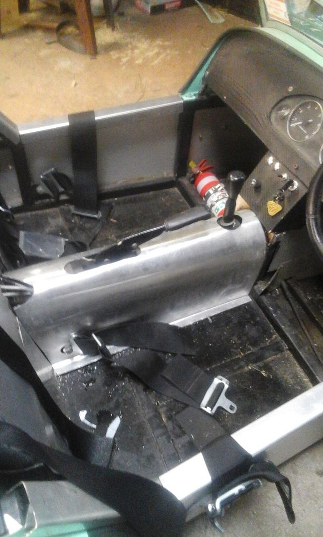

well tank is in and a sump added underneath. then as its a long holiday with some long service leave added in I thought I could do some finishing touches
the tunnel was just too big, so I cut it out and made a better one.
then I thought a new fresh skin would look good

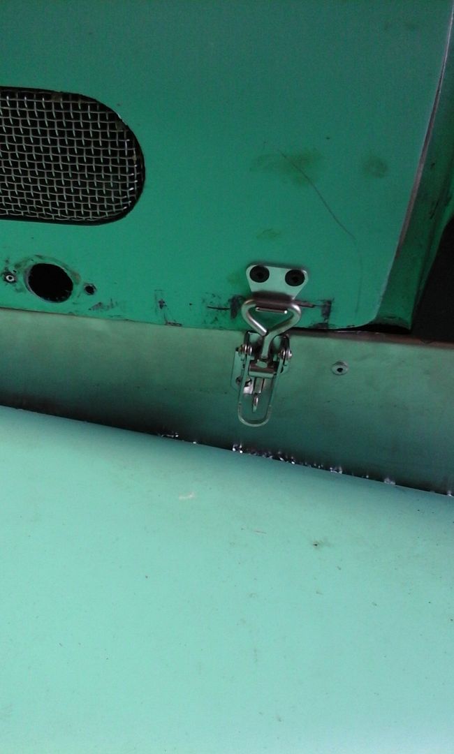

and then go rid of the dsuz bonnet latches I fitted, no some simple stainless clips
then I made a bimini top for it
MX5 powered Chevron in prep 2014

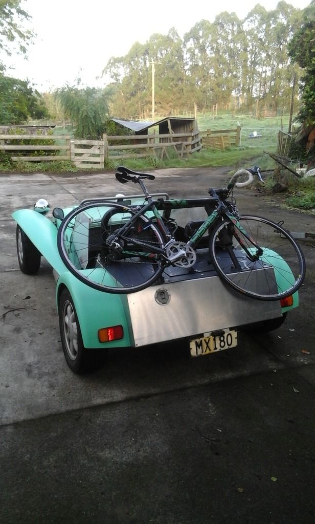

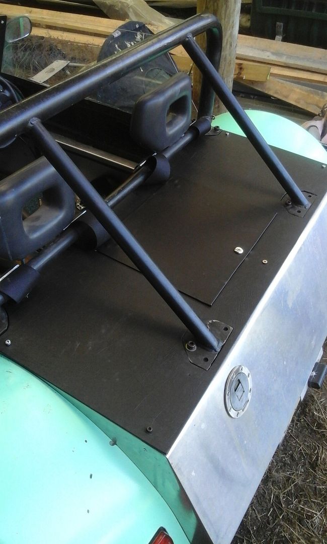

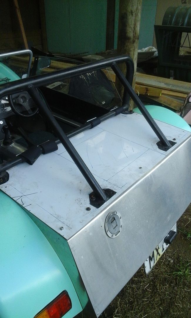

hard cover for the "boot"
cut some alloy to the shape and screwed it in
then covered it with Vinyl

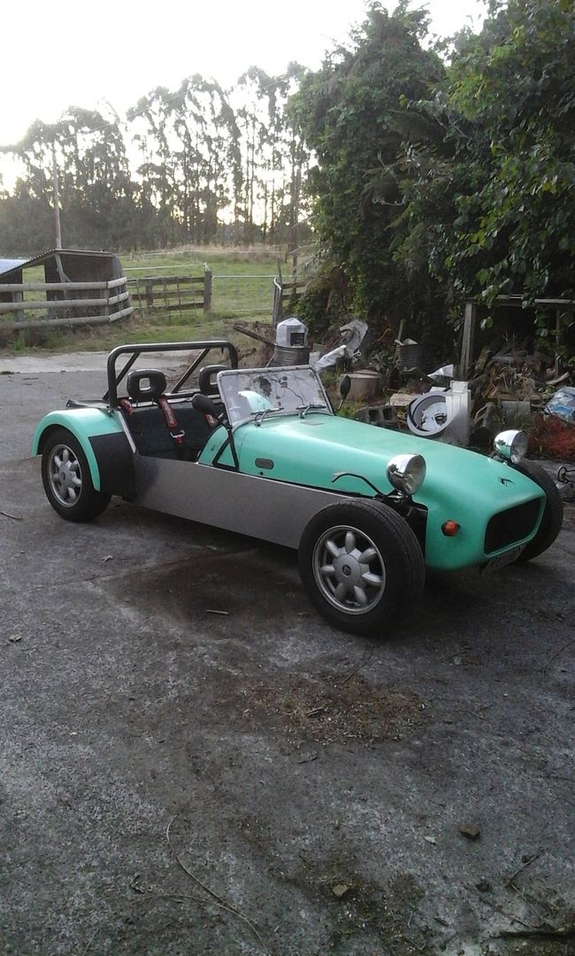

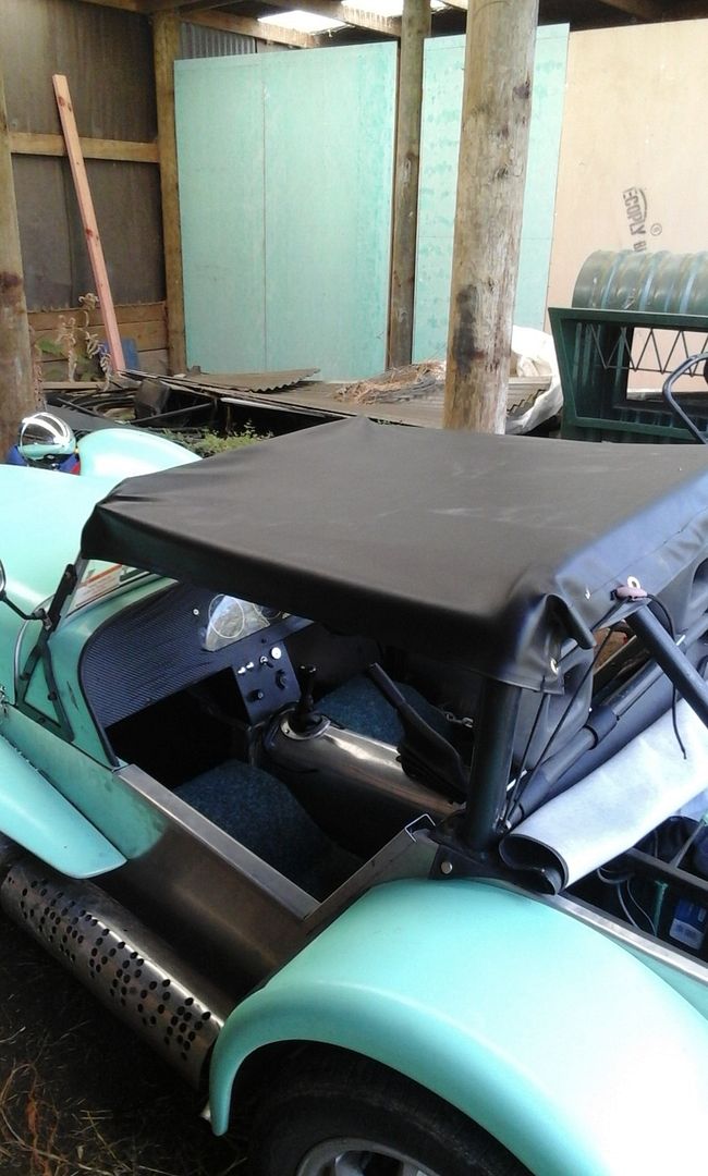

Post by JohnL » Sun Jan 07, 2018 7:34 am

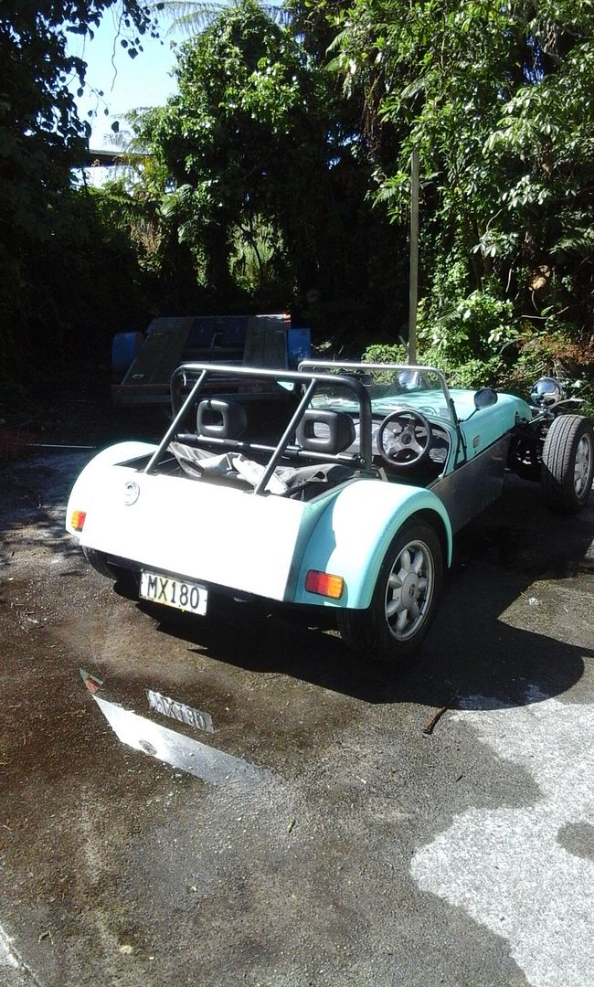

I remade the doors and made a roof, chur its like a proper job if you stand back
